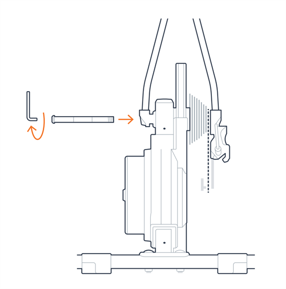

  4. Insert the thru axle from your bike from the non-drive side through the cassette on the trainer.
  5. Use an Allen key to tighten the thru axle to the manufacturer's specifications.
    Insert and tighten the thru axle

  3. Insert the thru axle from your bike from the non-drive side through the cassette on the trainer.
  4. Use an Allen key to tighten the thru axle to the manufacturer's specifications.
    Tighten the thru axle
